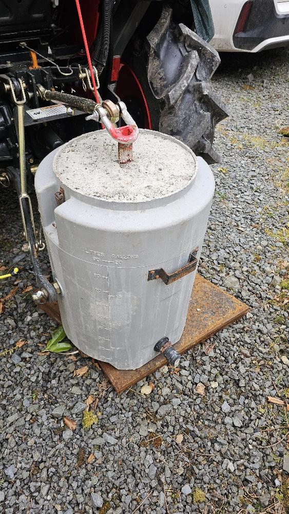

21. March 2025 at 15:23 #20005So, finally I have a weight at the rear. This is filled with concrete and heavey rocks to get the maximum weight from this barrel. The working liquid capacity is 90-litres (now filled to capacity) and is an old hoover/vaccuum cleaner dust holder – I think this is likely from an industrial machine. I estimate the weight to be closer to 200kg but I’m not sure – certainly over 150kg.
Now I can lift with the front loader without worrying about that being too heavy.
